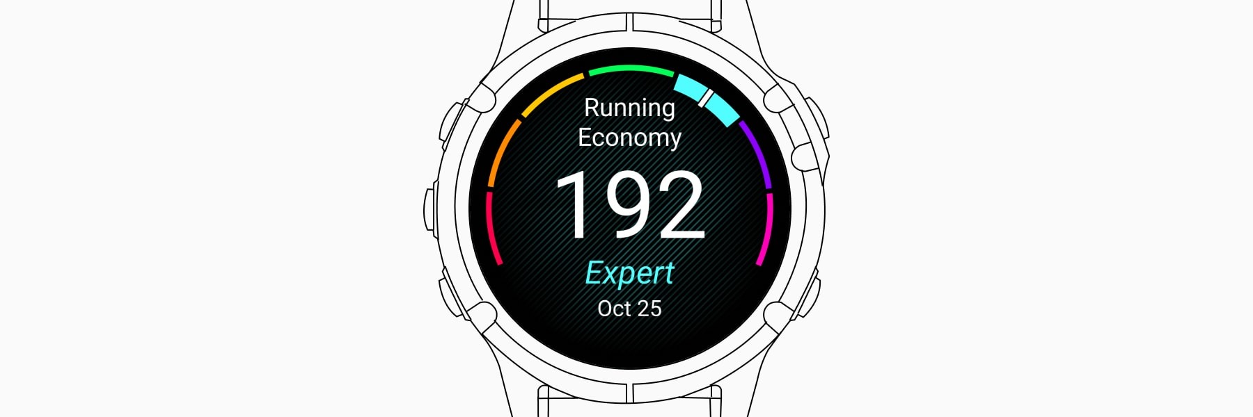

Running Economy
running-economy
Running economy is a crucial metric for any runner aiming to maximize their performance. It is a personal measure of the energy cost of aerobic running and reflects how efficiently your body converts that energy into performance on the road.
Running economy is expressed in milliliters of oxygen consumed per kilogram of body weight per kilometer (ml/kg/km). When interpreting running economy, remember that lower numbers are better, as it means less energy was used.
Knowing your running economy and seeing it change over time can be a game-changer. For two runners with similar aerobic capacities, the one with better running economy will typically have the advantage, as they will use less energy to sustain the same pace.
MEASURING RUNNING ECONOMY
To receive your running economy estimate, record your runs in either run or track run mode with a compatible Garmin device paired with a Garmin accessory capable of measuring step speed loss (such as the HRM 600 heart rate monitor).
Key inputs for the metric include heart rate, speed and running dynamics such as stride length, ground contract time, vertical oscillation and step speed loss. Step speed loss is an essential input, as it captures how much you slow down when your foot hits the ground. All inputs are contextualized with insight from your overall history. For best results, make sure your height and weight are set correctly, and sync your device with the Garmin Connect app regularly.
Running economy is not based on data from a single run, so expect to record at least 4 to 5 runs before receiving your first estimate. Combining data from multiple runs ensures that the insight you receive reflects your true performance in a meaningful way.
Keep in mind that running economy is ultimately all about aerobic performance, which means not every run you record will be equally impactful when it comes to calculating running economy. Easy runs of at least 30 minutes on a track or over relatively flat terrain offer maximum opportunity for gaining insight into this perspective.
Indoor runs and runs recorded as trail runs are not used to estimate or update your running economy. Rugged terrain and the frequently changing conditions of trail running obscure your true running economy. Similarly, runs recorded with a pack weight are also excluded from the running economy algorithm to ensure quality feedback.
IMPROVING RUNNING ECONOMY
Your personal running economy is influenced by both genetic and trainable factors.
The genetic element means that some runners tend to be more efficient by nature. Trainable elements include running style, flexibility and the efficiency of your cardiorespiratory, metabolic, and neuromuscular systems.
The fact that running economy is trainable means it is something that every runner can improve. At every level, working to improve your running economy is an effective strategy for boosting performance, minimizing fatigue and ultimately reaching your full potential.
New runners and those returning from an extended training break can see rapid improvements in their running economy. As runners gain experience, they tend to gravitate toward a more personally efficient running form. Seasoned runners, however, may notice slower progress, as the changes needed to further improve running economy are more subtle and demand sustained effort over time. Lasting improvements can only come from consistent, long-term running.
To improve your running economy, gradually increase your weekly mileage. As a rule, the more you run, the more economical your running becomes. For an extra boost, consider incorporating strength training and sprint workouts into your routine. These workouts stimulate the development of neuromuscular links supporting improved coordination and responsiveness, ultimately boosting your running economy.

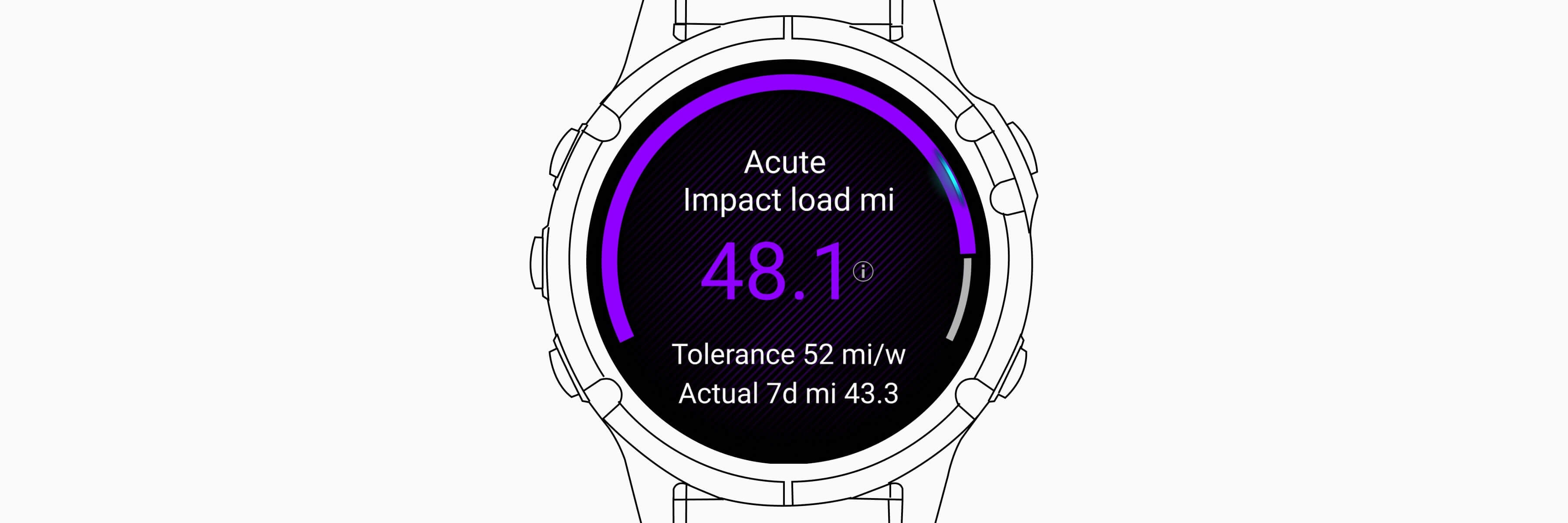

ACUTE LOAD AND TOLERANCE
Every runner knows that the effects of yesterday’s run don’t magically evaporate overnight. It takes time for your muscles, tendons, joints and bones to recover from the impact. This is why it is necessary to look beyond the impact of individual runs and consider the bigger picture.
An informed approach to load management requires understanding your current situation relative to what you are capable of handling. This allows you to dial in the right level of challenge without tackling more than you can handle. It also means being able to answer key questions such as, “How much headroom do I have today for running or for the rest of the week?”
  • Acute impact load is a weighted sum crafted to accurately reflect the cumulative and residual impact of your recently recorded runs. The full impact load of each new run is added directly to your acute impact load and the influence of that load diminishes gradually as time passes.
  • Tolerance reflects the maximum acute load that your body can manage based on your running history. It is personalized and adjusted at the start of each training week according to a science-based interpretation of your recent and long-term running history.
If your acute impact load exceeds your tolerance, you have entered a cautionary state. It doesn’t necessarily mean you need to stop running immediately. It is an encouragement to evaluate your situation and proceed with special care; however, consistently pushing beyond this limit should be interpreted as a potentially hazardous training pattern associated with increased risk of injury or burnout.
Whether from a single run or a few runs close together, how your acute impact load accumulates may extend the duration of your recovery time recommendation. Examples include going out for an especially long run or doing more downhill running than usual.
The training week screen offers a historical perspective that will help you keep tabs on training patterns. It is also where you can see how your running tolerance has changed from one week to the next. Consistently challenging training will gradually increase your running tolerance over time. Decreases in running volume will eventually result in lower tolerance for running. Keep in mind that weekly cumulative loads shown for your current training week chart may vary slightly from your current acute load. This is because acute impact load relies on a weighted calculation to reflect the current level of strain your body is experiencing today.

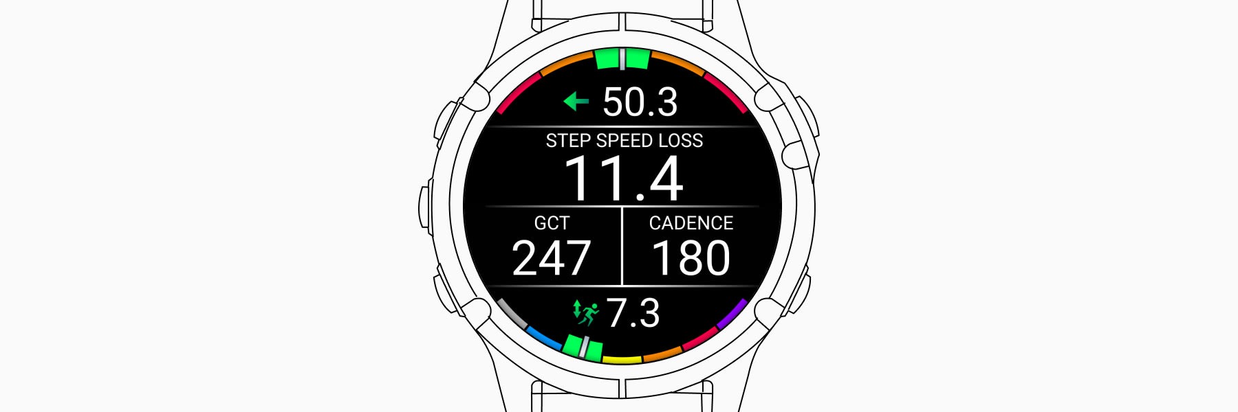

Running Dynamics
Ground Contact Time
This is the amount of time in each step that you spend on the ground while running. Ground contact time is typically pretty short, so it is measured in milliseconds. In fact, ground contact time tends to be especially short for elite runners, they will often have ground contact times of less than 200 ms. Virtually all experienced runners have ground contact times under 300 ms, likely because they have learned to “pick up” their feet quickly and not to over-stride as they are landing. Over-striding describes a running style where the foot lands too far in front of the body leading to braking forces at impact and, typically, longer ground contact times.
Ground Contact Time Balance
A watch screen showing ground contact time balance. By monitoring the balance between your left and right foot ground contact time (GCT), this measures your symmetry as you run. On your Garmin watch, it’s always displayed as a percentage greater than 50% with an arrow to the left or right, to show which foot is on the ground longer. For most people, a more symmetrical running form is preferable. Color gauges on Garmin watches and Garmin Connect™ show how balanced you are compared to other runners. Many runners report that GCT balance tends to deviate farther from 50/50 when they run up or down hills, when they do speed work or when they are fatigued. Anecdotally, some runners also notice that injuries are reflected in greater imbalance.

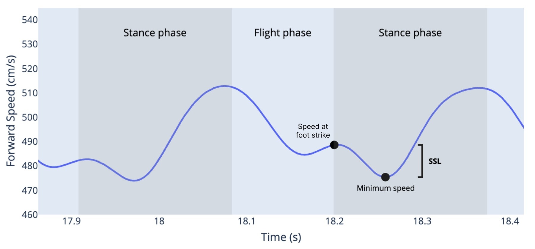

Stated simply, step speed loss (SSL) is how much you slow down when your foot hits the ground. To really understand what this means, it helps to know what happens to your forward speed over the course of each running stride. The graph below shows an example of one runner’s forward running speed over a couple of steps, as measured by motion sensors in the heart rate monitor.
A chart showing what happens to a runner's forward speed as their foot strikes the ground during flight phase and stance phase, and how step speed loss is measured.
As shown in this example, even when you are running at a constant speed, you still slow down after you first contact the ground, and then you speed up again in the second portion of stance phase. SSL is the difference between your forward speed when you first hit the ground and your minimum forward speed. So, it’s a measurement of how much you slow down, or brake, for every step. It is measured at the chest by the heart rate monitor in units of cm/s.
SSL is affected by how you run. When you run with a lower cadence or overstride, it tends to increase SSL. This higher SSL means you have to do more propulsive work to speed back up again in the second portion of stance phase, so lower SSL is generally better. Running cues that may help you improve your SSL include trying to run smoothly and lightly as well as reducing your step length.
When you are running on hills, gravity acts as a decelerating force when you run uphill — and as an accelerating force when you run downhill. The barometer in your watch detects the grade, enabling the SSL metric to account for the effect of gravity. As you would expect, SSL is typically lower when running uphill and higher when running downhill. Note that inclines are not accounted for when you run on a treadmill, as the treadmill grade is not measured by the watch.

You can add SSL% as a data field on your watch to see it in real time next to SSL, or you can check it post-run as a time-series chart in the Garmin Connect app.
